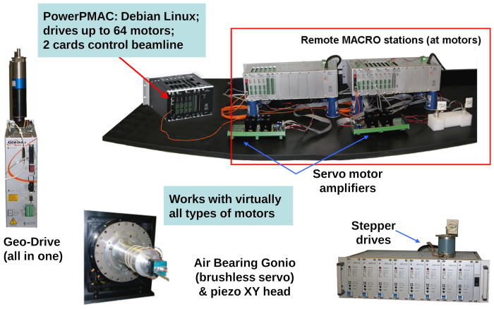

  1. Two PowerPMAC IOCs running inside PowerPMAC motion controllers by Omron can drive up to 128 motors and thus provide all beamline motion controls. These controllers operate under embedded Debian Linux and the EPICS driver for them was implemented in-house.

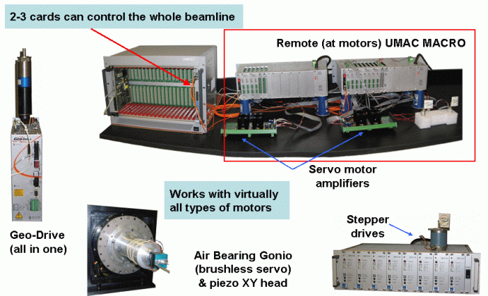

The core of the whole control system are PowerPMAC motion controllers that we made available in EPICS. The advantages of these controllers are (see the picture below):

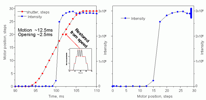

Using these controllers we implemented on-the-fly scans for beamline alignment. The scans are partially based on an open-source FastScans project formerly carried by Elena Kondrashkina and Sergey Stepanov while they were employed at BioCAT. The package consists of a number of programs written in C language with user-friendly GUI frontend developed in Java.
As illustrated by the scan plot, the actual motion time of the shutter is about 12.5 ms and the beam blocking occurs within 2.5 ms.
