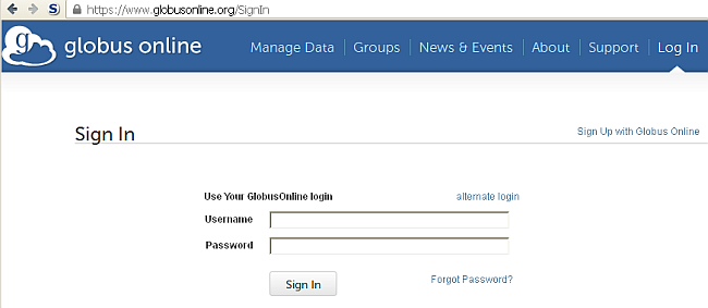

  1. Login on Globus. There are at least three ways to do it:
    • If your institution has an association with Globus, then you can login to Globus using your existing organizational login. Navigate to https://auth.globus.org, choose your institution from the dropdown link and click "Continue". It will bring your institutional login web page when you will need to enter your institutional username and password. Then, your institution will authenticate you with Globus.
    • If you have a Google account, you can use it too. Navigate to https://auth.globus.org and click on "Sign in with Google". Then follow the prompts.
    • You can create a Globus ID personal account (one time for life) at https://www.globusid.org/create, Then, navigate to https://auth.globus.org, choose "Globus ID" from the drop-down link and click "Continue".

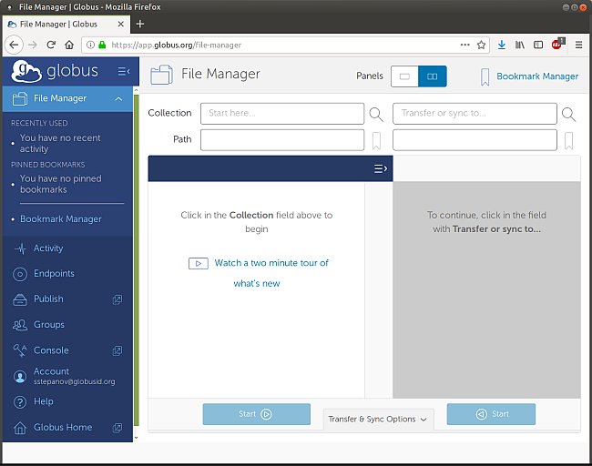

  2. Once you login, you will see the File Manager interface. Choose the two panels option at the top as one panel (normally left) will be showing your home directory at GMCA and the other one will be showing a directory on your computer.

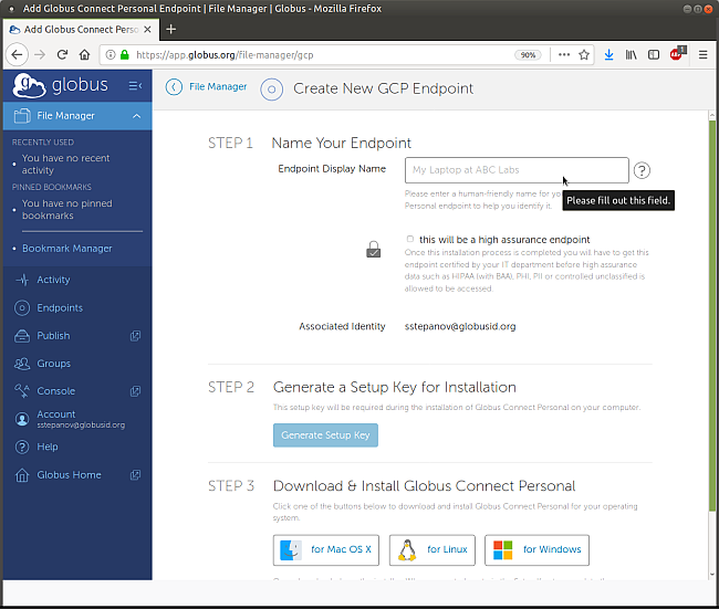

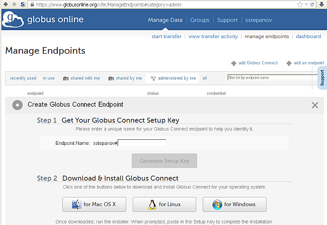

  3. If you already have globusconnect application installed on the computer (the application which will be receiving data) and the computer already has an encryption key registered with Globus under your account), then skip to Step-4. Otherwise install globusconnect on the computer and obtain a unique computer Setup Key from Globus. Click into any of the two "Collection" fields to reveal the globusconnect download link:
    The above link brings you to the page where you can generate your personal Setup Key (if needed) and download Globus client for MacOS, Linux, and Windows:
    • Name your data-receiving computer as a new Globus Endpoint. Then, generate the computer Setup Key by pressing the "Generate Setup Key" button and copy this key to clipboard. You will need to provide this key to Globus Client after the installation.
    • Download a one-click Globus Connect Setup for the operating system of the data receiving computer. The application is available for MacOS, Linux, and Windows. Note the place where you saved the installer (e.g. on the Desktop or in the "Downloads" folder).
    • Unpack and install Globus Connect by running the downloaded Setup application. When Setup asks you for a setup key, paste from clipboard the previously copied Setup key. More detailed instructions can be found on the Globus website.

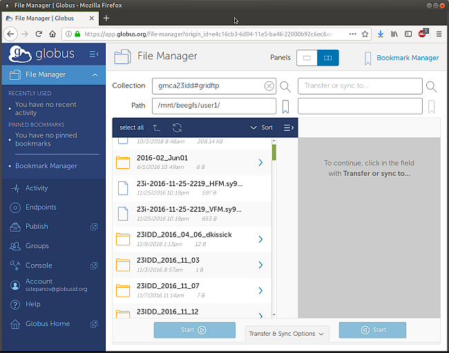

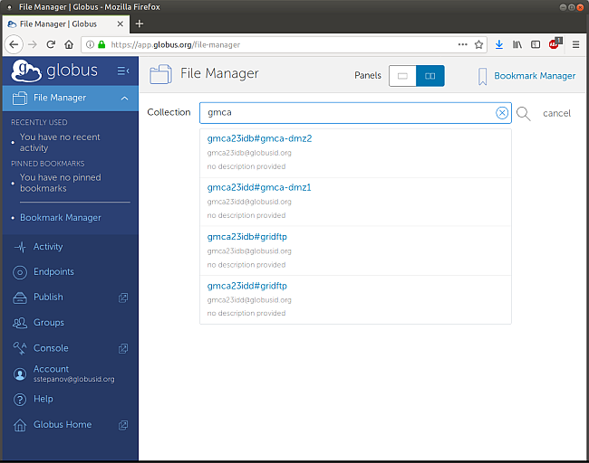

  5. On the Globus Connect web page, start typing gmca in the left "Collection" field to display the GMCA endpoints. Then, select one of the following endpoints:
    GMCA 23ID/APS Data Collection
    or:
    GMCA 23ID/APS Data Collection 2
    You can select any of the two regardless of the GMCA beamline you used.

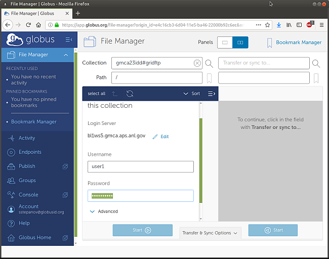

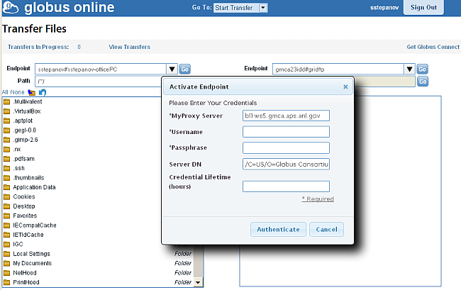

  6. Enter your ANL username and password as prompted to access data at GMCA. Please note that access to GMCA computers with your ANL account is normally active for 2 days after your beamtime to avoid interference with other users. However, if there is an unforeseen reason for an extension, please contact your host.
  7. Once the ANL username and password are accepted, you should see your folders at GMCA:

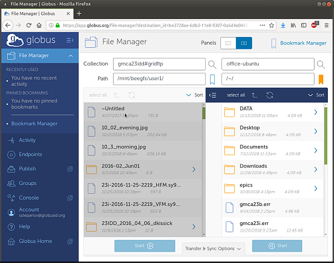

  8. Click on the right "Collection" pane and choose your local endpoint on the "Your Collections" tab:
  9. After that you should see a listing of local directory in the right pane;
  10. Select a file or directory and click on the highlighted "arrow button" to initiate the transfer:

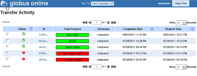

  11. To watch the file transfer progress or possibly cancel a transfer, choose "View Transfers" from the drop down menu in the top bar of the Globus Online web page. The screen will look like this:
